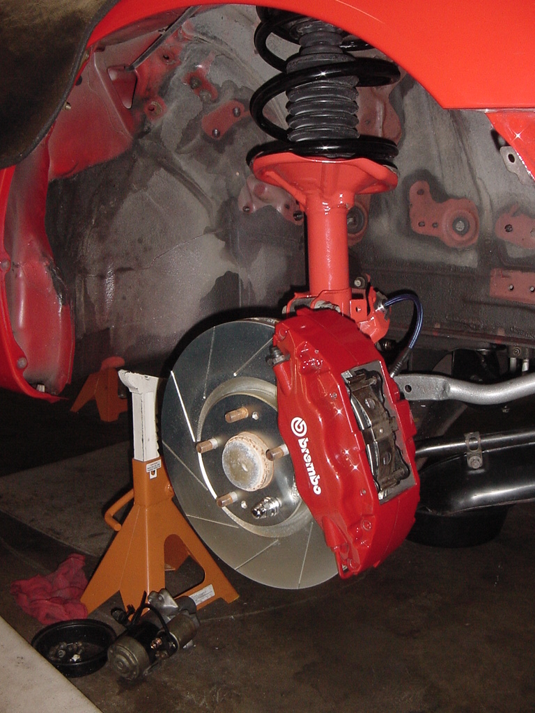

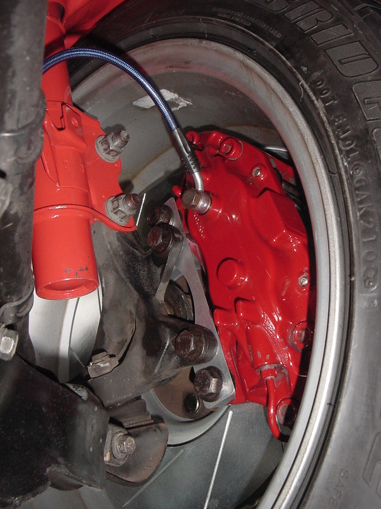

The Mitsu EVO Brembo caliper is MUCH larger then the Z33/R33 Orange Brembo calipers and it uses a larger pad. I have that kit on my S14 and it is VERY good and the caliper is closer in design to a StopTech or BremboGT caliper then the Nissan OEM Brembos.

Point I'm trying to get across is that I have prob seen, installed, handled and driven a very wide selection of brake options for this car.
This is the set up on my S14 it dwarfs the stock Z32 calipers/rotors
